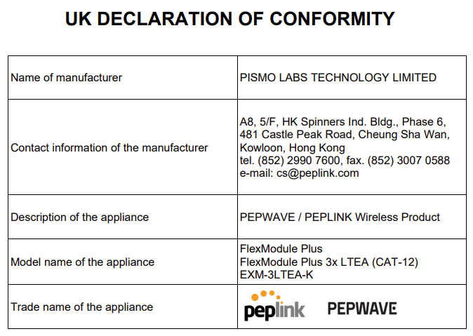

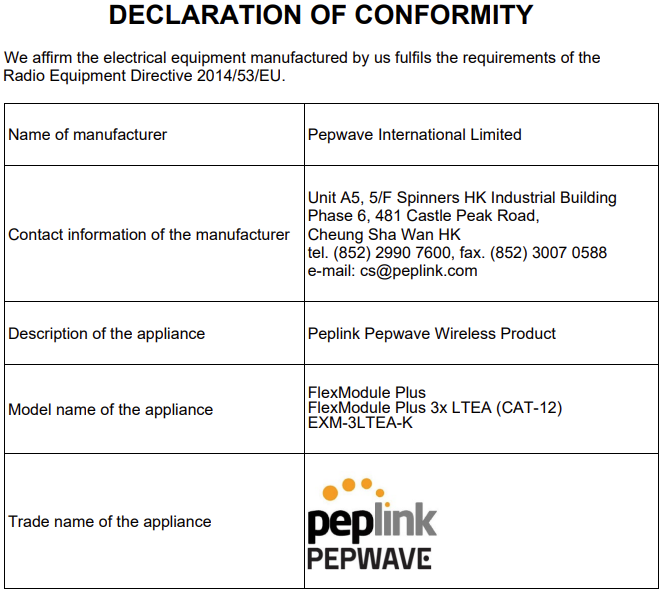

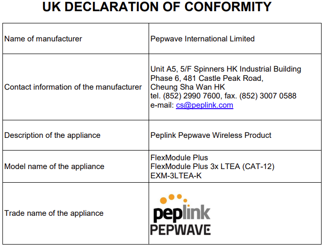

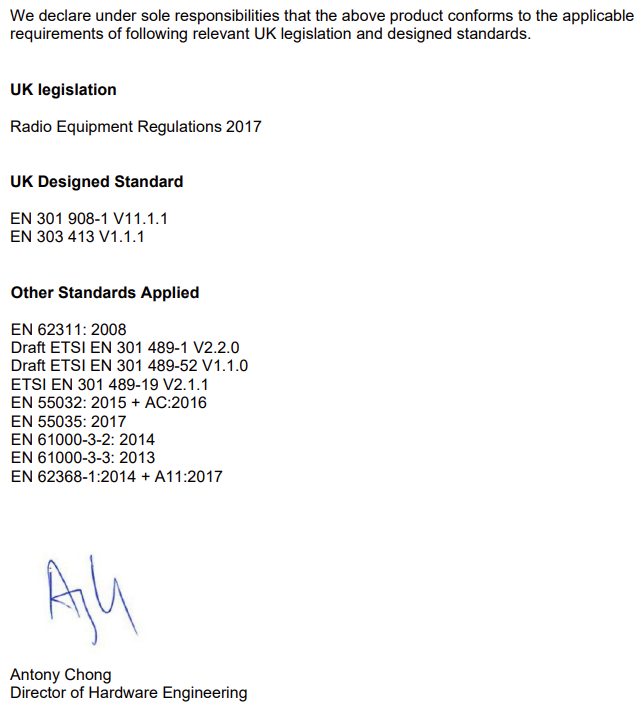

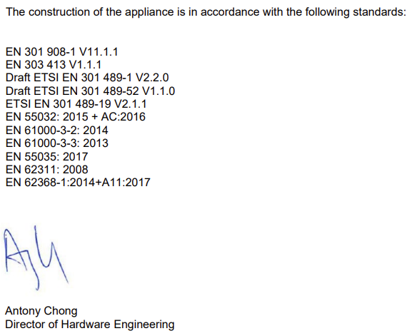

Declaration#
Details of the declaration can be found here.
