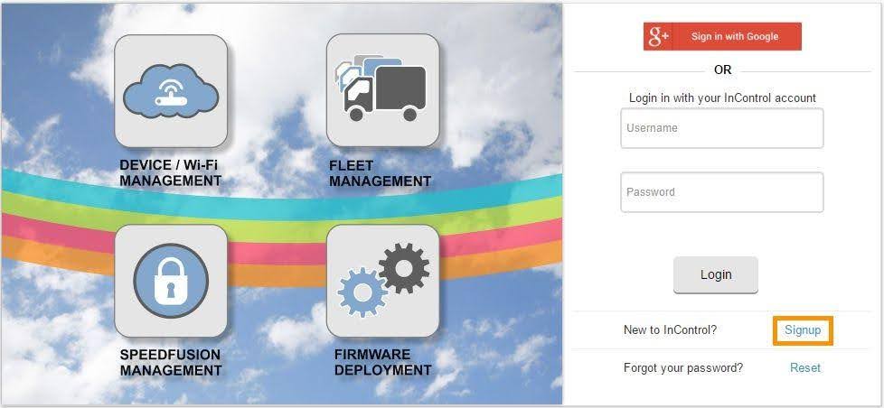

  1. Navigate to the InControl 2 login page at ​https://incontrol2.peplink.com​. Click the ​Signup​ link, in the lower right corner.
  2. Enter an e-mail address that will serve as your login name.
  3. Complete the remaining fields. Click ​Submit​ to continue.

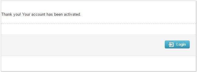

  4. You will receive a confirmation e-mail. Click the ​Activate Account​ button in the confirmation e-mail.
  5. Click the ​Login​ button to re-display the InControl 2 login page at https://incontrol2.peplink.com​.

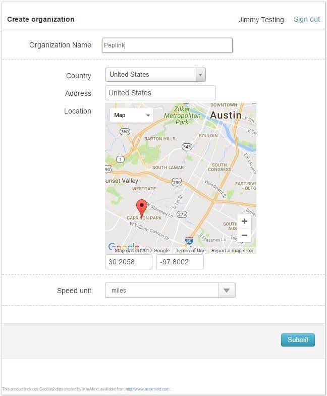

    When you log in to InControl 2 for the first time, you’ll be prompted to create an Organization.
  7. To get started, enter organization name, country, and address information.
  8. Check to see that your location has been correctly identified. If you want to specify a different address than the one shown, you can select it using the map, type it in the ​Address​ field, or enter the coordinates below the map.
  9. Choose ​miles​ or ​km​ as your ​Speed​ ​unit​.
  10. Click ​Submit​ to create your organization.

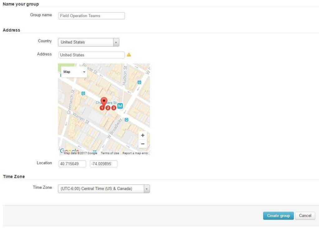

  11. On the ​Create Group​ page, displayed next, name your group. If needed, change address and time zone details. Click ​Create Group​ to finish.

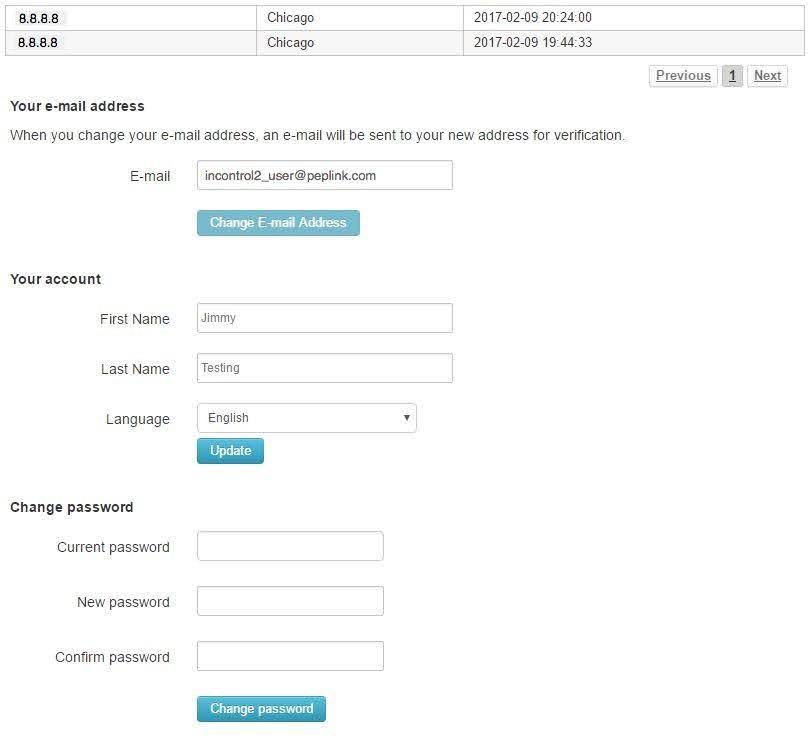

Changing Login Details
  1. To change login details, click the user name link displayed in the upper right corner.
On the Account page, you can change your login e-mail address, account name, language, and password. You can also review recent logins to ensure that the account has been accessed properly.

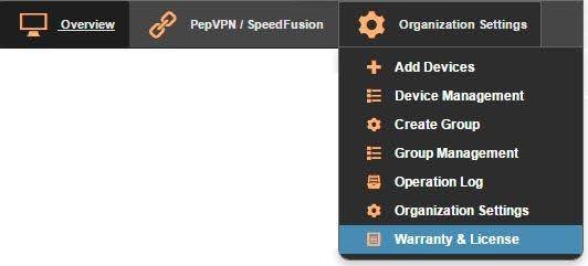

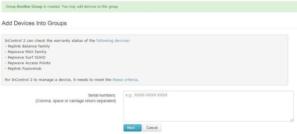

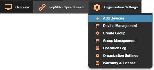

Adding Devices
1. To add new devices, click Organization Settings > Add Devices.
You can also add a device from the . Click Group, then choose the desired group from the drop-down menu. When the screen opens, click Settings > Add Devices.
2. On the Add Devices Into Groups page, choose a group from the Select Group drop-down menu. (If you are already at the , you will skip this step.)
3. Enter one or more serial numbers.
4. Click the Next button.
InControl 2 will check to make sure each device is valid for use with the software, and is not already in use. The results will display in a table.
5. If the device is valid, the table will show the device name, address and location. Click the Add Devices button to add it to the specified group.

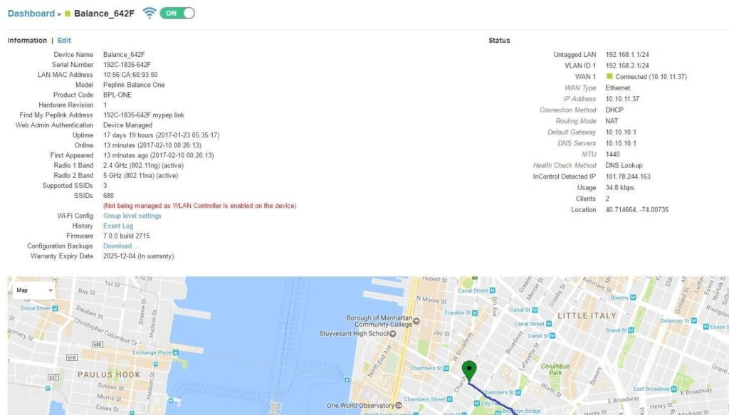

1. To display device management data for individual devices, click their names on the Dashboard Device List and on most reports. You can also click Organization Settings > Device Management at the , and Settings > Device Management at the to display a list of devices.
2. Clicking a device name displays its detail page, which provides in-depth device information, as well as access to Wi-Fi settings and the Event Log report. You can also download configuration backups to use in device restoration and additional device configuration.

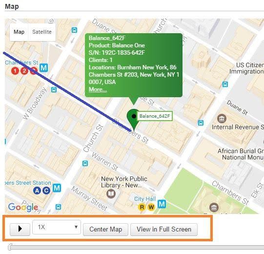

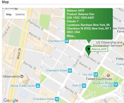

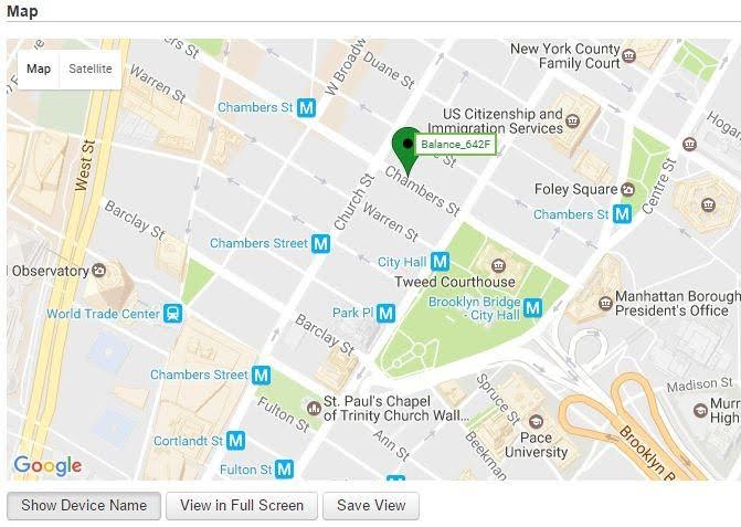

3. For GPS-enabled devices, you can track location in real time or display historical route information. You can also color-code routes by speed or coverage, specify a custom tracking time frame, get real-time traffic information, and more.
Creating Groups
1. To begin adding groups, click Organization Settings > Create Group.
2. On the Create Group page, name your group and, if needed, change address and time zone details. Click Create Group to finish.

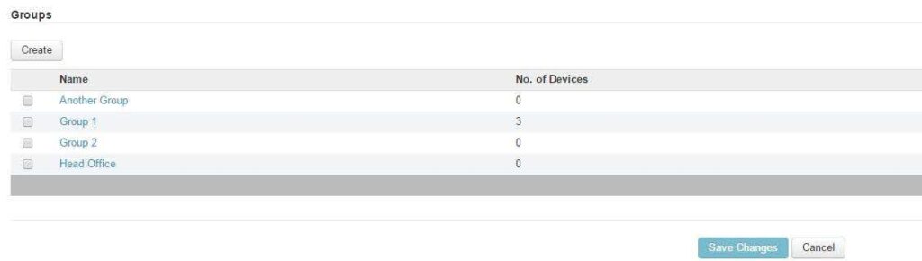

Managing Groups
1. Click Organization Settings > Group Management.
On the Groups management page, you can delete, rename, and create new groups.
2. Click the Create button to enter a new group.
The Create Group page opens. Follow the instructions in the previous section, Creating Groups , to add a new group.

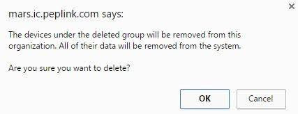

3. To delete or rename, click the box beside the group you want to change. Immediately, the Delete and Rename buttons appear above the table.
4. Click the Delete button to delete the group.
5. Click OK in the dialog box to complete the delete.
6. If you want to rename a group, click the Rename button.
7. Type the new name in the editable Name box that opens.
8. To save your work, click the Save Changes button.

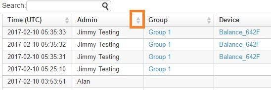

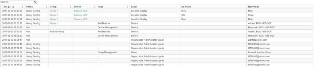

Viewing the Operation Log
  1. To display the operation log, click Organization Settings > Operation Log.
Here, you can view all past operations or search for operations that meet particular criteria.
To sort the view, click the arrows next to the table headings.

Managing Warranty and License Information
1. To view and manage device warranty and license information, click Organization Settings > Warranty & License.
2. Here, you can filter the list to show warranties that are close to expiring, as well as those that have already expired. You can also import FusionHub license keys, create an evaluation license, and download the latest FusionHub firmware.

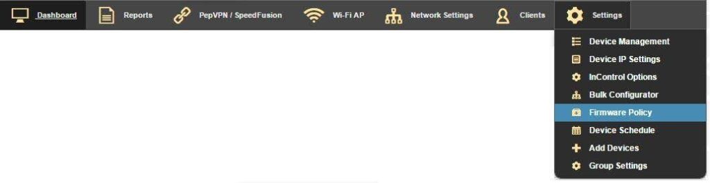

1. To view and manage firmware updates for your devices, select the appropriate group from your Groups drop-down menu.
2. Click Settings > Firmware Policy.
3. On this page, you can view firmware versions, as well as set group policy for firmware update frequency. To save your work, click Save Changes.

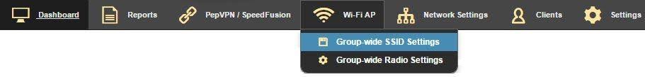

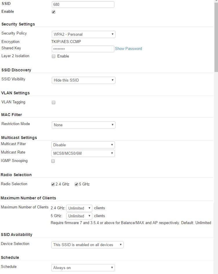

Configuring Wi-Fi
1. Select the appropriate group from your Groups drop-down menu.
2. Click Wi-Fi AP > Group-wide SSID Settings.
On the Group-wide SSID Settings page, you can enable/disable available Wi-Fi configurations.
3. To change SSID settings, click the identifier in the table.
In order for the edit page to open, Wi-Fi Management must be checked.
The SSID Settings page displays a variety of Wi-Fi configuration settings.
Group-Wide Settings
SSID Enter a name for the Wi-Fi network.
Security Settings Security Policy – Choose from Open – No Encryption, WPA2 – Personal, WPA2 – Enterprise, WPA/WPA2 – Personal, WPA/WPA2 – Enterprise, and Static WEP.
Layer 2 Isolation – Enable/disable Layer 2 port isolation, which can prevent unauthorized port-to-port communication.
SSID
Discovery
SSID Visibility – Available values are Show this SSID and Hide this SSID. Note that hiding the SSID does not prevent access to users who know the SSID.
VLAN
Settings
To insert a VLAN ID, click the box next to VLAN Tagging.
MAC Filter Restriction Mode – Deny or accept all MAC addresses, except those listed in MAC Address List, which displays if you select either Deny or Allow.
Multicast Settings Multicast Filter – Enable or disable multicast filtering.
Multicast Rate – Choose one of the options to change the balance of multicast speed/range.
IGMP Snooping – Click to turn on.
Radio Selection Both 2.4 GHz and 5 GHz are selected by default, to support communication in every mode.
Maximum Number of Clients The default for both radio selections is Unlimited. Use the drop-down list to change that number.
Device Selection Enable the SSID on all devices or on devices with the specified tags.
Schedule The SSID Settings are always on.
4. Click the Save Changes button when you are finished.

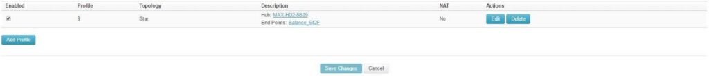

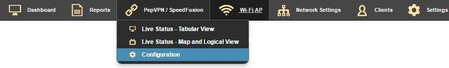

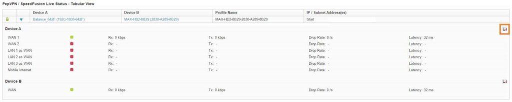

Configuring PepVPN / SpeedFusion Endpoints
1. If allowed by your deployment, you can configure PepVPN / SpeedFusion endpoints right from InControl 2. To access this feature, click PepVPN / SpeedFusion > Configuration.
2. Next, check Enable to display configuration settings.
All enabled profiles will display in the table under the map.
3. To make changes to an existing profile, click the Edit button.
4. To add a profile, click the Add Profile button.
5. Enter the following information as you are prompted to do so:
End Point Configuration
Topology Select Star, Fully Meshed or Point-to-Point.
Choose Endpoint Devices Click next to the device for which you are adding this profile.
Choose Hub Device The IP address or hostname assigned to the hub will display here. Click the High Availability Setup box to enable HA. Then select the appropriate group and device for your HA deployment.
The Profile Summary displays next. It contains the following additional information.
Profile Summary
Encryption Toggle 256-bit AES encryption; in most cases, it’s best to leave encryption turned on
NAT Mode Check this box to enable network address translation
Data Port The default data port is 4500; port 32015 will be used if port 4500 is unavailable
Send All Traffic to Remote Hub Internet traffic from LAN clients on the endpoint device will be routed to the remote hub site over the SpeedFusion connection instead of routing to the device’s WAN port(s)
Link Failure Detection Time Choose the amount of time between link status checks; lower values enable faster detection but consume more bandwidth
WAN Smoothing Choose Normal, Medium, High, or Off.
WAN Priority If you select Change WAN Priority, the next screen that displays will allow you to change priorities for one or more of the PepVPN profiles.

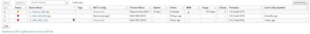

Using the Dashboard

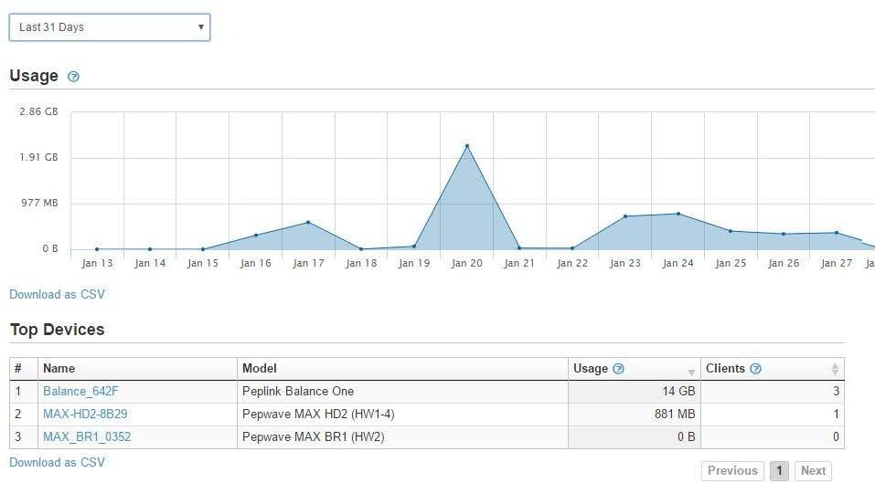

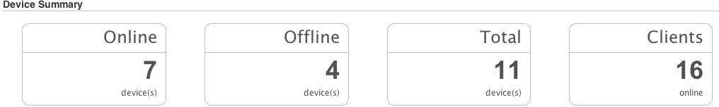

The Dashboard provides a wealth of at-a-glance data about online and offline devices, client statistics, location, and more. To access the Dashboard, select a group and then click the Dashboard icon located in the navigation bar.
Device Summary
This section offers a quick overview of online, offline, total online and offline, and connected client devices, all updated live.
Device List
The Device List displays important device information that can be easily sorted so you can quickly find just the information you need. The Device List also provides quick access to device management tools and group-level Wi-Fi settings.
Map
The map lets you keep an eye on your whole fleet in real time. Icons are marked with the name assigned to the device being tracked. Icons with numbers indicate multiple devices in the area.
To get details, including a complete route history, click any map icon.
To see a device’s route history in motion, select a speed and click the play/pause button.

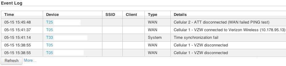

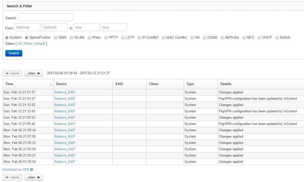

Event Log
The Event Log keeps you up-to-date on client connection/disconnection, data session times, time synchronizations, and more. For details on client devices, click the appropriate listing in the Client column. To display the Device Management page for a device, click its listing in the Device column. To display the entire Event Log report, which can be downloaded for use in other applications, click More…
Getting Detailed PepVPN/SpeedFusion Information
InControl 2 makes it easy to monitor the real time performance and activity of PepVPN / SpeedFusion endpoints. To get started, select a Group. Then click PepVPN / SpeedFusion > Live Status – Tabular View.
To see receive/transmit, packet drop rate, and latency statistics for a listed endpoint, click the disclosure triangle.
For a visual representation of this data, click the graph icon on the right.
Hover over graphed lines to see details. You can also click items in the graph legend to show/hide them.
Monitoring Clients

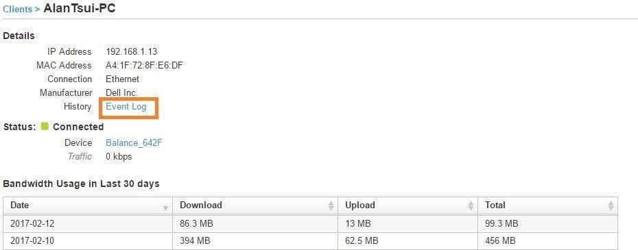

InControl 2 offers comprehensive client reporting in real time. To access a list of all connected clients, click Clients in the navigation bar, when you are on the  .
For detailed information on a connected client, click its link in the Name column.
On the Clients detail page, you’ll see the client’s current location, as well as other data. To see historical data for the client, click Event Log.

Bandwidth Reports
The Bandwidth Report represents real-time, per-minute, hourly, daily, and monthly bandwidth statistics. You can display the data for WAN, LAN, or mobile internet connections.
Hover over any data point for download, upload, and total information.
The same data displays in a table below the graph. Click Download as CSV to save the data to a spreadsheet or database.

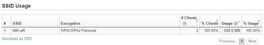

Wi-Fi Reports
This report offers the same data as Device Reports, plus an SSID usage table to help you determine which access points are handling the most traffic.

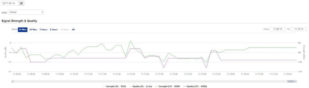

Cellular Reports
You can take a look at signal strength and quality over time–from ten minutes to 12 hours–with the Cellular Report.
Hover over any data point for strength and quality information.
The map below the graph allows you to filter and display the results by strength and/or quality.

Event Log
The Event Log lets you track any kind of system event and can be filtered using an array of presets. You can also specify custom report filtering criteria.
